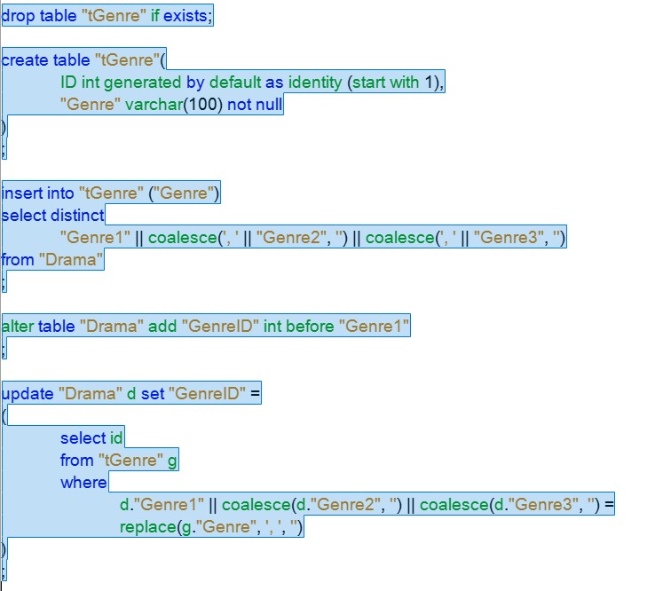

I copied the code you supplied, and expected issues with the typographic quotes the Ask LO site imposes. I was not disappointed in that expectation. :slightly_smiling_face:
After trying a couple of times to replace all the curly quotes, I tried one block of code at a time with replaced quote marks. This enabled the creation of the tGenre table, but when it came to the coalesce code, I am stuck. It was the SINGLE typographic quotes that seem to be causing LO problems. I hope the following screenshot, showing 2 different attempts, illustrates the problems one with the single typographic quotes replaced, one with them left as is:
@UncleRobin,
yes you are correct I just tried copying and pasting code from this site and the quotes were altered.
if code is altered then I guess that makes this site unfit for purpose!
I have uploaded “EmptyDatabase” it contains a single query (the code).
drag and drop your table “Drama” into this database then try the code, it should go through in one shot.

Wow! Thank you so much for going to all this trouble. Here is what happens when I copy the SQL from the query you wrote and paste into Tools>SQL. First a screenshot of the text copied from the query, to show that I haven’t altered or omitted anything except the commented out portions
Pasting that into Tools>SQL returns this message

@UncleRobin,
Using HSQLDB embedded (default database):
I have tested the code and provided that the table Drama (case sensitive) exists then the code goes through in one shot.

My apologies! I did not even notice that the table name in the code you provided was “Drama”. I’m very sorry for having wasted so much of your time when I ought to have seen the problem straight away - my tables is “Dramas” :man_facepalming:t3:
