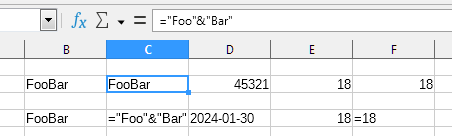

Just do your research - some simple test with values that you understand will give more information than our explanations.
Sub testSetArray
Dim oSheet As Variant
	oSheet = ThisComponent.getCurrentController().getActiveSheet()
	oSheet.getCellRangeByName("B2:F2").setFormulaArray(Array(Array("Foo"&"Bar","=""Foo""&""Bar""","2024-01-30",18,"=18")))
	oSheet.getCellRangeByName("B4:F4").setDataArray(Array(Array("Foo"&"Bar","=""Foo""&""Bar""","2024-01-30",18,"=18")))
End Sub
Type of data passed to the method as a parameter
Thank you for your interest. This helps me a lot to understand
Hallo
…additional: setFormulaArray() allows also numeric primitives in the Input!
The main-Difference is:
Calc evaluates Strings only from FormulaArray but never from DataArray
The other way round:
getFormulaArray casts anything to string
getDataArray returns the original Data
