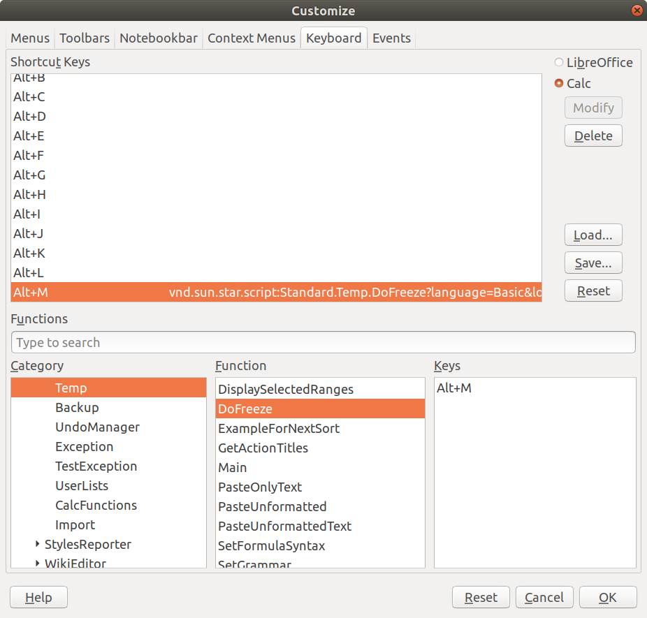

You can call the procedure yourself (Alt+F11) or create a button in the menu to call it:
Tools - Customize - Tab: Menus Toolbars - Category: Macros, Search: DoFreeze - Select DoFreeze - Define scope & Add item to selected target: Standard (select the last item to add after)
Updated
Or set the key to call the macro (I used Alt+M):
Note: In my notebook
