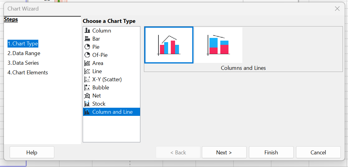

  • Select your 3 data series
  • Insert -> Chart
  • Select Column and Line in Choose a Chart Type
  • Click second icon Stacked Columns and Lines
  • Click button Finish
image description
Hope that helps.

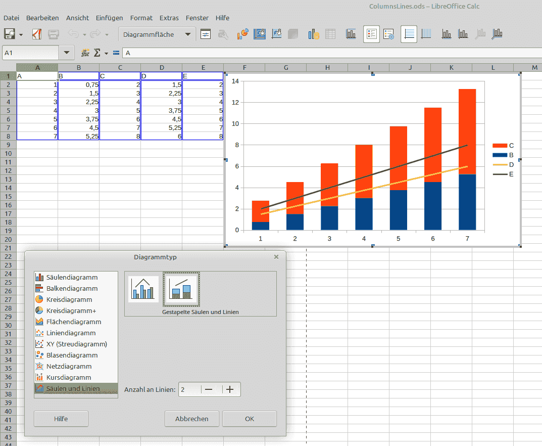

Is there a way to change the line to column and vice versa after making the chart?
Yes - use Right click -> Data Ranges and the Up and Down arrows to reorder the data series and use Right click -> Chart Type to redo the chart type definition and you may get something like:
The last entry in the **Data Series:** pane seems to constitute the "line".

I do not get the option to select the number of lines. Any idea why?
Outdated version?
My version:
Version: 25.8.4.2 (X86_64) / LibreOffice Community
Build ID: 580(Build:2)
CPU threads: 2; OS: Linux 6.8; UI render: default; VCL: gtk3
Ubuntu package version: 4:25.8.4~rc2-0ubuntu0.24.04.1~lo1
OK, that worked thanks. Version was 25.2
It took me a while to realise that it forces the first column to be the bar so I had to jiggle the table, create the chart, then restore the table to where I wanted it.
