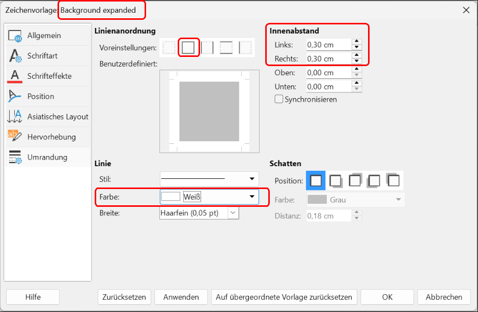

Since a border is required, it should be chosen in white so that it is not visible.
The space before the word “background” can then be omitted.
Select the color in the “Highlighingt” tab.

Regarding your question about some extra highlighting before and after the word, you can solve this by adding Borders to your character style.
  • go to Borders tab
  • uncheck Synchronise box and set some Padding at Left and Right
  • define only vertical borders at left and right
  • in Line section, either set Color to white (or to page background colour) or to the same colour as your background highlighting (the latter has my preference because it does not create a constraint with the page style).

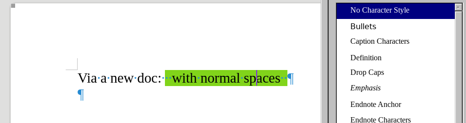

I did exactly the same as before in a new document (doc2) : it works. I can have trailing space with the same background color without any other character.
I copied the line from my document doc.odt to a new document doc3.odt : it works too.

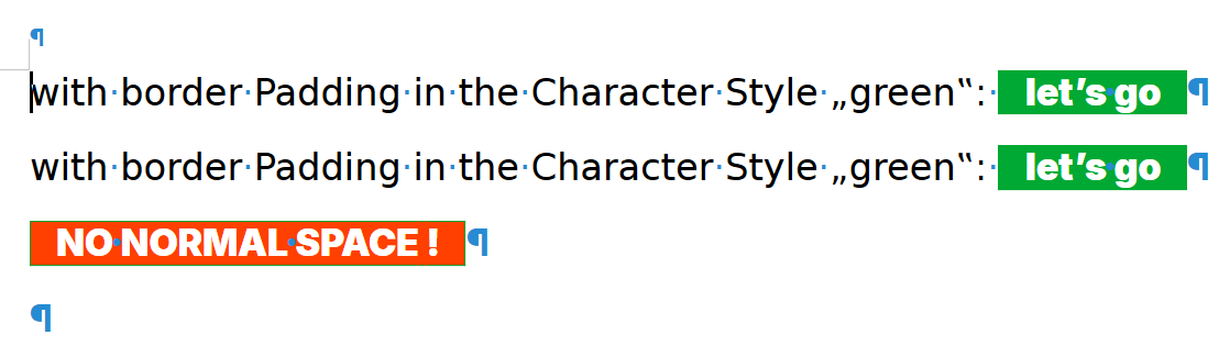

Don’t use normal space!
Look in the Character Style “green” at Border Tab for “Padding” and “Line”.
41040 HB 2026-09 for export.odt (15,8 KB)

As I said, in a new doc, trailing spaces before line break, after a word with a background color (direct formatting, NO style) use the same background color : they are not left blank, and this doesn’t need any style:
How is it possible in a new doc, and not in my first document ?
The file odt:
with normal spaces.odt (10.0 KB)
