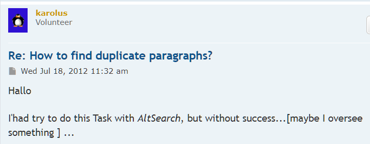

https://forum.openoffice.org/en/forum/viewtopic.php?t=54995&p=241710#p241076
But not being a coder I’m not sure how to try it out. The thread seems to imply that the code is applied via a Macro. If so, does anyone know how?

On the same forum where you found the solution, in the Tutorials section there is a separate thread How to install a code snippet
Test if it can be done with this extension
As far as I remember, in that discussion it was said
I don’t think anything has changed in 12 years
In case you decide for python…apso.oxt helps you to manage code-snippets in python
…except the code!
12 years later I would use:
