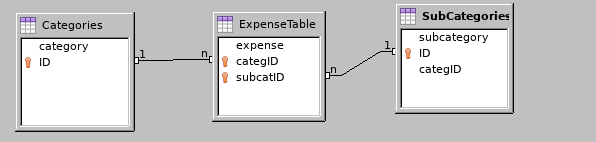

Bildschirmfoto von 2025-07-07 15-10-28
This is a many-to-many relation. Each category is associated with zero, one or many sub-categories and vice versa. The expense table maps which (sub-) categories belong to each other.
My understanding of categories and subcategories is different. IMHO, it should be a one-to-many relation where each subcategory belongs to one category and each expense belongs to one subcategory.
"Buy items of subcategory “fruit” in category “groceries”.
