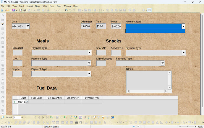

I receive this error code when opening the form created from Getting Started Guide. The list box does not show up when clicking the payment type boxes. How do I fix this?

Thank you for replying. Here is the properties of the form box requireing list box entries
So I have it exactly the way the getting started guide said to do, so not sure what else is causing the issue?

I went back in the form, ( Reviewed each “Payment Type fmt” I was missing the sql on the last one and had sql native there, I corrected. I went through and added a space to Payment Type in the sql because it was missing. The error is gone, but I still don’t get a selection of the payment type as shown here

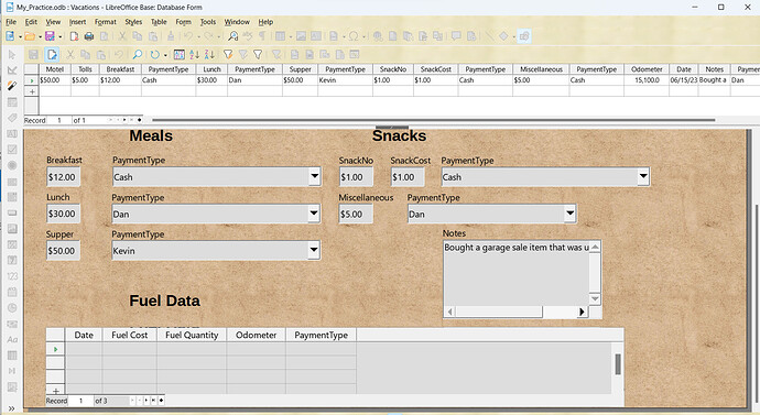

The above resolved the issues as posted. There is one thing I need to request information on and that is after making these changes, the form does not list the results in the table on the form as shown:
@RobertG is there something I may have messed up in the links that show the records in the subform table? I am so sorry for having to ask more from you. But I really appreciate the level of intelligence you display here. Thank you so much for helping me. edited to add, the table has the entries as shown above, but thetable in the form is also suppose to show the record correct?

@andieguess : Have seen the screenshot, which doesn’t show any entry in table control. When testing your example I will get the content here.
Open the form for editing, not for input data.
Mark the table control → right mouse click → control properties → font. Change the font from default font to any other font. Also change the width of the font.
First screenshots you have made will show the data - and suddenly there aren’t shown data? Might be something with refresh of the screen …
