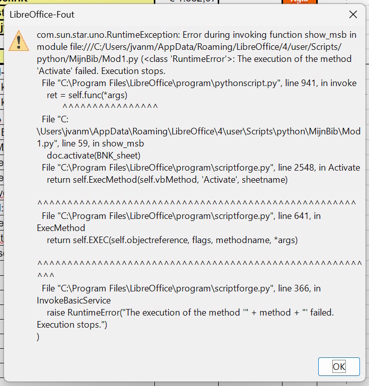

Only each subsequent launch after a quickstart produces errors. It seems that information isn’t being reloaded or that old information isn’t being cleared out, causing errors.

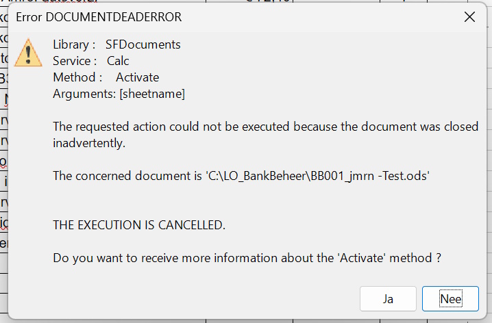

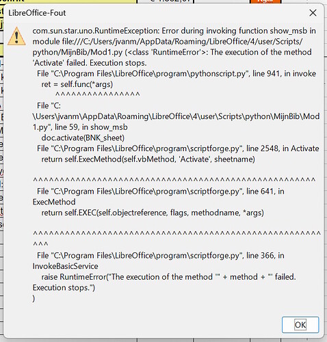

These ase the error messages:
and
Looking at the error messages again, I get the impression that the APSO extension is no longer present when the Calc application is next started after using Quickstart. This would mean that when using Python scripts in Windows, LibreOffice Quickstart cannot be used.

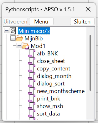

But it’s completely unclear, where is APSO there - the error message mentions ScriptForge, but I see no APSO there. (And I would very much suspect ScriptForge. @JPLED could have more insight.)

The error message is raised on the code line 59
doc.activate(BNK_sheet)
and indicates that the doc object refers to some Calc sheet that disappeared, probably due to a user interaction.

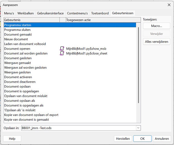

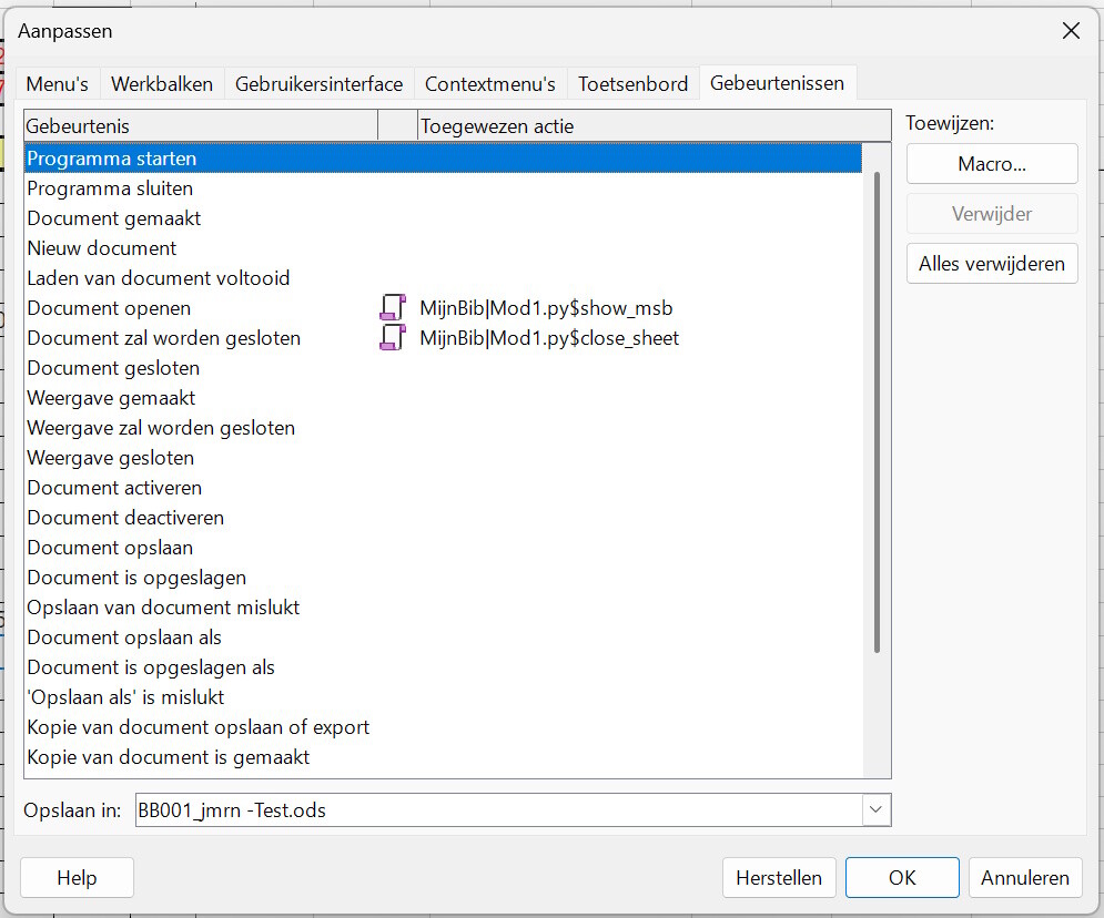

There is a trigger at the opening of the document and there is a trigger when the document is closed.

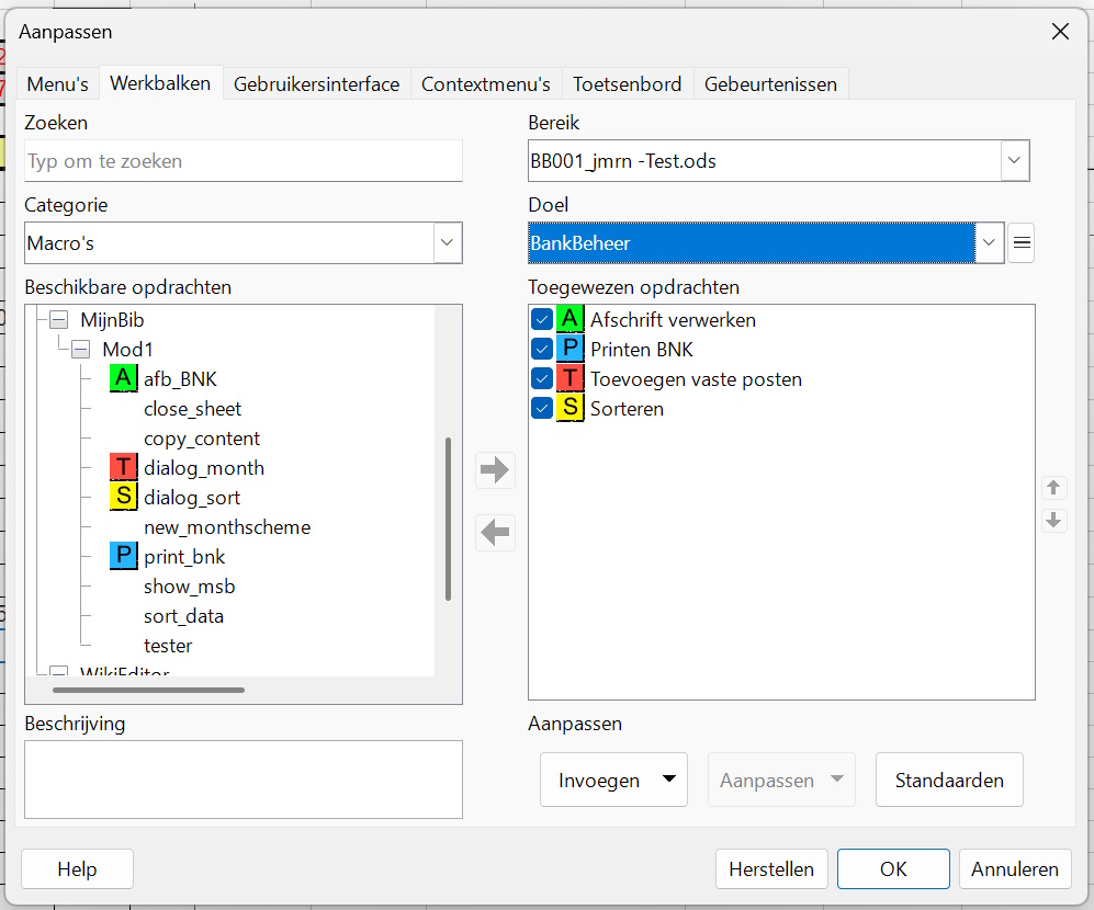

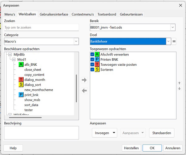

Furthermore there are four triggers in a menubar.

Indeed, the above error message is displayed and the execution stops. It seems logical that, even when you reopen the document that was just closed before, a new instance should be created and assigned to the same or another variable.
My perception of the issue here is that the statement
doc = CreateScriptService('Calc')
(line 8), which is defined at the global level of the python module is executed only once at module loading. The Quick Starter forces any such module to remain loaded until a real LO stop.
(I don’t see a bug here).
I would insert before line 59 next lines:
global doc
to reinitialize doc each time the document is reopened.
