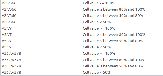

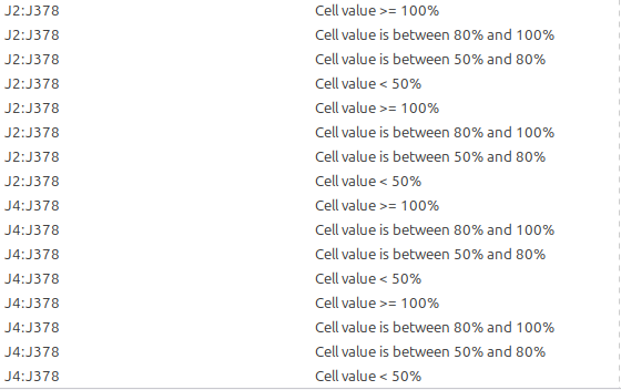

Also, the conditional formatting is messed up, i didn’t made it like this:
1
2
3
4
Why are there duplicates of the same conditional, how can this issue be solved, and how can I stop the program from grouping the ranges when the condition is the same?
