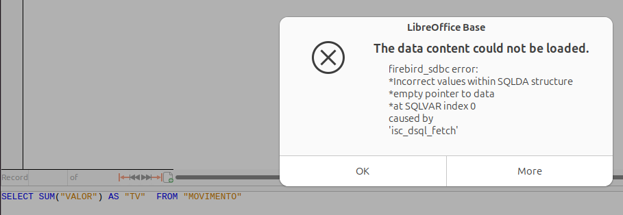

SUM in Firebird Embedded
Hi.
I know this is a question about Firebird, not about Base proper, but anyway…
Both parsed and direct mode.
SELECT * FROM MOVIMENTO
runs :ok:

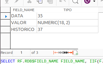

[VALOR] = NUMERIC(8, 2)

Any suggestions?

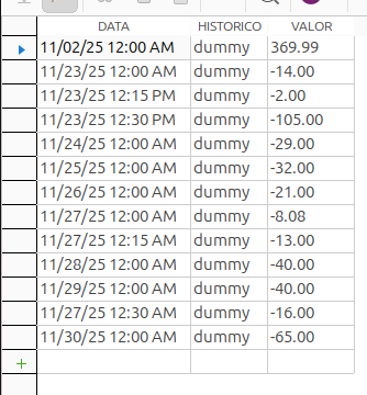

You could see all data when switching to the tables pane?
Have read about problems with newer packages of Ubuntu/Debian, because the distributions try to connect to the internal Firebird database with Firebird 4, not Firebird 3. Packages, downloaded from LibreOffice directly, helped here.
SELECT SUM( "Preis" ) AS "SumValue" FROM "tbl_Ausgang"
will run here without any problem. “Preis” is DECIMAL(12,6) here.
Yes, I can.
And also SELECT * runs :ok:

Then it seems like “VALOR” isn’t recognized as NUMERIC(8,2). Might be the result is bigger than NUMERIC(8,2)?

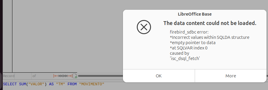

Try
SELECT SUM(CAST("VALOR" AS NUMERIC(10,2))) AS "TM" FROM "MOVIMENTO"

Have tested this - without any problem when setting a column to NUMERIC(18,2) or NUMERIC(8,2). SUM will be executed right way.
I would test the original packages from LO, not from Ubuntu.

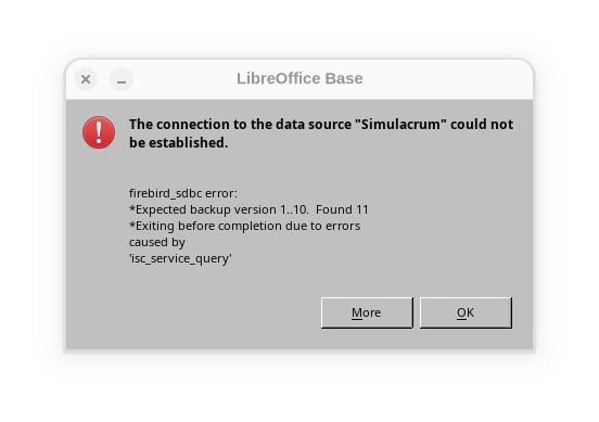

See my first comment: Ubuntu (and all deb-versions) packed LibreOffice to work with Firebird 4.0, but the version of LibreOffice is 3.0. Backup version 11 is a version of Firebird 4.
Error here on OpenSUSE with original packages is the same as reported by @Villeroy
If you want to use base don’t use the LO-versions, which are packed by the distributions. There are often special bugs (with Firebird, ReportBuilder …) which won’t appear in the original packages of LibreOffice.

You might need to also check whether Ubuntu separately installs an incorrect version of Firebird, which it then hooks (but doesn’t enforce dependency on) to the apt LO packages.

Have installed many versions here this way (for *.rpm). No problem running Firebird there with any function, which is supported through LO driver. Linux distributions won’t install the driver from LO. It isn’t only a problem of “function not working”. You couldn’t open the database on other systems where LO Base expects Firebird 3, not Firebird 4.
