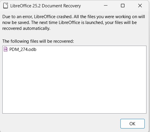

Good night to all. I’m very new in DB creation (studied some things but 30 years ago) and this is my first attempt to create a functional Database with a purpose.
I’m using HSQLDB 2.7.4 connected via JDBC. Windows 11, LO 25.2.5.2.
The problem is: I was using a Form to put some data in the DESENHO table. Got an error, go to crash report and reopen the DB. Table DESENHO got corrupted since then (there’s no way to enter any record).
I’ve deleted the Table, recreated with all the relations, but it gives the same error and corrupts the Table.
Can you give me any advice, please?
Thank you!
PDM274.zip (75.9 KB)
Could you tell the error message?
It simply goes down after I try to fill the first record. I write some stuff but as soon as it goes to the 2nd record it crashes.
After recover, DESENHO table no longer allows to insert records, shows no lines at all.

Recreate all the DB from scratch from DUMP.sql
Exactly the same error. Libreoffice goes down with Document recovery window. After that Table DESENHO get unusable.
