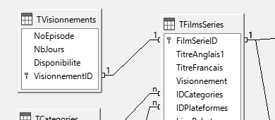

@Villeroy, I created the table with the SQL statement you suggested by modifying the column names to make things work with my DB.
The table that I call “TViewings” was created correctly.
If I understand correctly, you are implying that this “TViewings” table would or should be associated with a subform of the parent form which is linked to the “TFilmsSeries” table? Is it correct?
If I wanted to create a new form whose role would be to display only the records whose check boxes are not checked in order to more easily manage the extras linked to these records. I would therefore need a query linked to this new form in order to display certain fields from the “TFilmsSeries” table and the “TViewings” table.
Would the relationship between these two tables as you proposed allow this?
Main form: TFilmsSeries (or anything providing a valid series ID).
Subform: TViewings with a link from the FilmSeriesID to TViewings.ID.

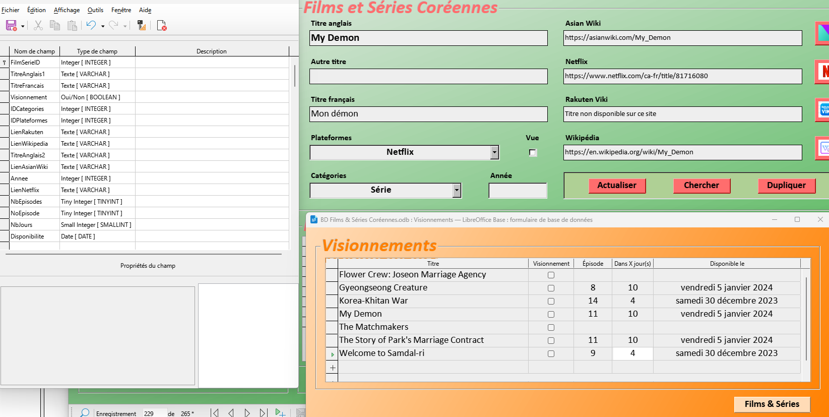

I understand that I am not very clear in my requests and explanations.
I will try to clarify things. They say a picture is worth a thousand words so see a screenshot:
Currently I can achieve what I want using the “TFilmsSeries” table. All fields of the “FilmsSeries” form are clearly identified, including the fields which are only used by the “Visionnements” form which are “TitreAnglais1”,. “Visionnement”, “NoEpisode”, “NbJours” and “Disponibilite”.
The check box of the “TFilmsSeries” form allows you to know which series have not been viewed. The viewing form therefore only displays the series not viewed and it allows you to indicate an episode X will be available in X day(s) therefore on date X. The goal is to have follow-up regarding these series currently being viewed.
However, I find or I should say that I think that the 3 columns “NoEpisode”, “NbJours” and “Disponibilite” take up too much space unnecessarily in the “TFilmsSeries” table, so I like Villeroy’s idea to have a table dedicated to these 3 columns was probably better at the organizational level.
Capture d’écran 2023-12-26 131339
The reason I want this in a new form is that I don’t want to have to completely reconfigure the “FilmsSeries” form to make space for a subform and additional fields.
Being lazy by nature, I figured it was simpler to create a new “Viewings” form to do this tracking. That’s what I did.
Now I want to take the table that Villeroy suggested and use it in relation to the “TFilmsSeries” table for the “TitreAnglais1” and “Viewing” fields and the fields of the new table that I called “TVisionnements” so that everything can work with the “Visionnements” form.
Unfortunately, pictures tell nothing unless you have a display issue.
series_viewings.odb (13.4 KB)
The form starts with series filtered by those which have not been viewed yet (series 3 and series 4). On the toolbar you can turn that filter on and off.
