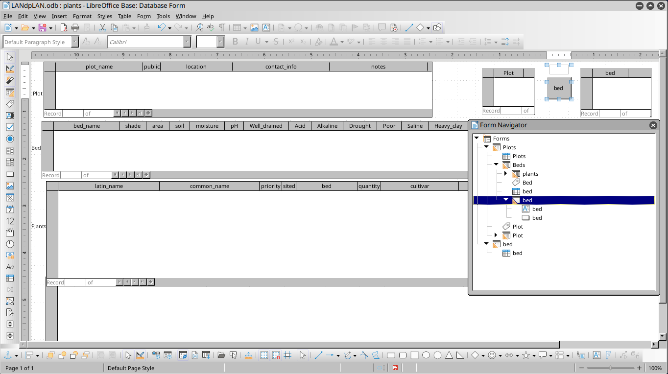

Table refresh on button push
This button puts “beds.bed_id” into a new record on “bed.bed”. I want the “bed” table to refresh automatically so that I can see the new record without needing to click in the table and then click refresh.

    ' Re-query the data for the form (this should update the table control)
    oBedsForm.reload() ' Reloading the entire form to refresh all controls, including the table control

https://forum.openoffice.org/en/forum/download/file.php?id=35500 refreshes anything anywhere in the same form document after some record has been inserted, deleted or updated.
  • Run the install macro in the downloaded Writer document.
  • Add a hidden control to your form that is going to be modified (form navigator, right-click>New>Hidden Control)
  • Name it “AutoRefresh”
  • Add the hierarchical name(s) of one or more forms, list boxes or combo boxes, separated by semicolon.
  • Bind the form’s “After record action” event to the installed macro MyMacros>pyDBA>AutoRefresh>formAction
Sample:
../Form2/TableControl/Lisbox1;Subform refreshes “Listbox1” in “TableControl” which is part of “Form2” in this form’s parent node ../ AND this form’s “Subform”. The entries are separated by semicolon.
With this setup, you can use the same unmodified macro code for all use cases.

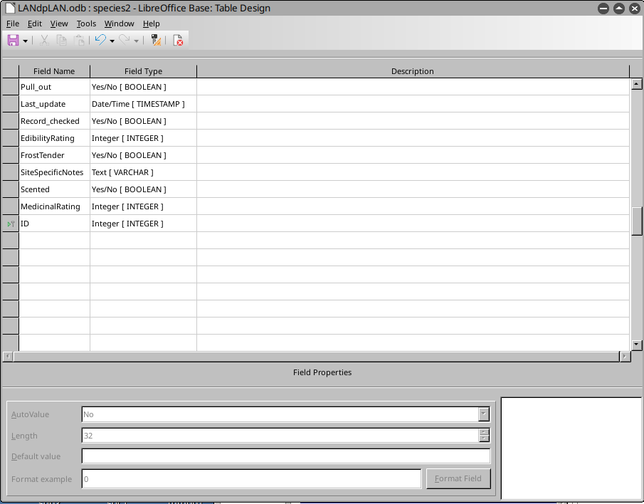

BlockquoteThen save odb! Now set the auto increment of field ID to “YES”. Save and close table! Save odb! The empty “species_2” table is now ready to be appended with the data of table “species”.
Step 3: If I save the option to change AutoValue becomes grey/unchangeable. If I change AutoValue to Yes, after I press save it goes back to NO and becomes grey/unchangeable.
In a LO Base connection to a split hsqldb database, anytime that a table’s field properties need changed, they may be edited in the script file of the split odb. Before starting, there must not be any other field in the “tableName” marked as Primary Key. (right click far left row marker) There must also exist a simple integer field like “ID” with default properties
  • Save and close the odb! In the split odb folder, open the odb “mydb.script” file with a text editing app (notepad, or notepad++) and scroll to the line that starts with CREATE CACHED TABLE “tableName”.
  • Carefully replace - “ID” INTEGER - with - “ID” INTEGER GENERATED BY DEFAULT AS IDENTITY(START WITH 0) NOT NULL PRIMARY KEY - (Use “wordwrap” to see the whole line without horizontal scrolling).
  • Save and close the script file! Reopen the odb and check tableName.ID properties again. The ID properties will still be “greyed” out, but the auto-increment should now be YES and the row marked as Primary Key.
  • This is the easiest way IMO to edit the ID field properties in an empty table! Do not try this with a populated table as existing data will be cleared. An alternative method exists using the SQL tool, but for me, this method is much quicker and straight forward.

pTable2 definition or data should never be changed. It is the “exact” copy of the original pTable. pTable is the only one to be modified (edit “ID” INTEGER …) before appending the pTable2 (original data) back into it.
