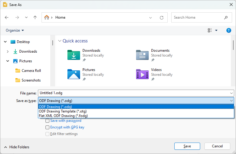

In LibreOffice, you can’t edit a JPEG file. In general, the file types that are considered editable by LibreOffice modules are found it respective modules’ File → Save As... dialogs. Note that for Draw, this dialog currently only contains three file types: odg, otg, and fotg. No “jpg”.

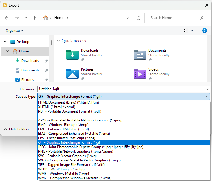

There is also File → Export..., with more file types. But that export dialog is exactly for the file types that the program can generate for export, not for the file types considered “editable”.

This is important to realize. The distinction is the essence of the differentiation between the two dialogs (Save As vs. Export). And this is the reason that you see what you describe.
And of course, this is reasonable for Draw. You seem to expect that Draw is a JPEG editor. No, it is not any kind of raster image editor at all. It is vector-based. It imports any raster images as vector primitives (each containing the raster as its content), and it may export the whole scene it generated, or its selected parts, to a new raster file; but it doesn’t pretend to edit these files.
