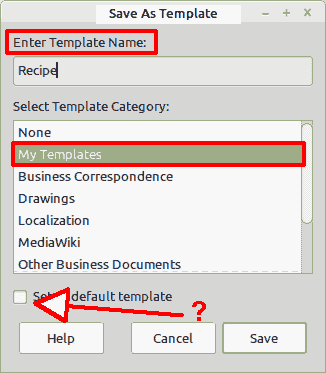

Open Recipe.ott and you will get a file like Untitled 1.odt. Open Menu File | Templates | Save as template… (Recipe) (see screenshot). Now this file will be copied in the templates folder as Recipe.ott.

To set it as default template means that if you start a simple new Writer document it will be based on Recipe.ott. (In most cases this will be not useful - but can be done for some time, if you have to work the most time on new recipes.)
