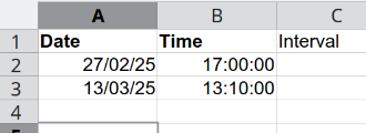

Time interval between 2x dates/hours
Have a spreadsheet with a Date column, and an hour/minutes (24hr) column, and would like to be able to have a 3rd column of the difference. eg
So, in the interval column, C3, would like to calculate the difference in days:hours, between Row2:(Date/Time) and Row3:(Date/Time) 13:21:10 (I think??? :slight_smile: ) As in 13days:21Hours:10mins.
Thanks.

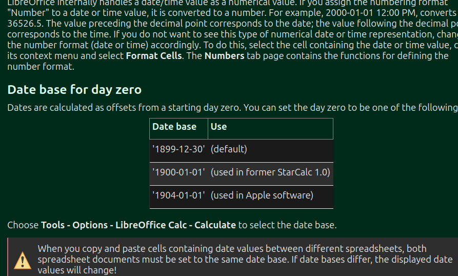

Internally Calc saves dates as number of days since begin of the 20th century and time as fractions of a day, so 6:00 is 0.25 and 12:00 is 0.5 resulting in 1 for 24 hours. This design allows to add and subtract dates/times quite easily.

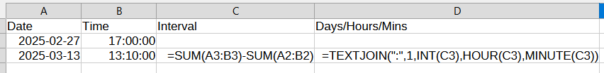

=A2+B2 would give you a timestamp and you can use the difference to other timestamps like
=(A3+B3)-(A2+B2)
For your differenc the part left from the decimal points is your number of days, the fraction to the right will represent hours/minutes. (Edit: above image by @PKG shows how to convert this to a text-string yourself)
Problems are lurking, if cells “look like” date/time, but are effectivly strings (text) and don’t try to use the same format-codes as column A or B in C.

is it ? 12/30/1899

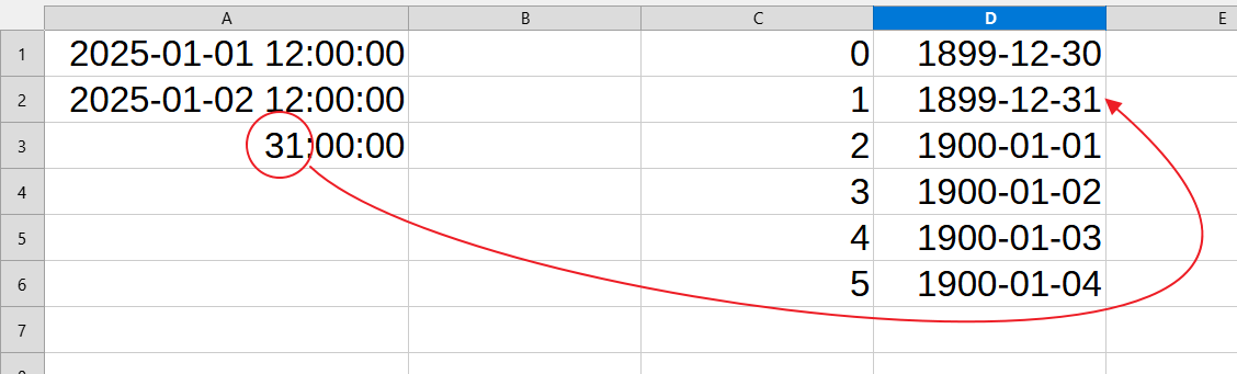

NO it never return correct results:
duration in days as »D« day of month
1 31
2 1
3 2
4 3
5 4
6 5
7 6
8 7
9 8
10 9
11 10
12 11
13 12
14 13
15 14
16 15
Yes, I agree, I wrote nonsense.
because [brackets] doesnt change the meaning of D from day of Month into duration of days
