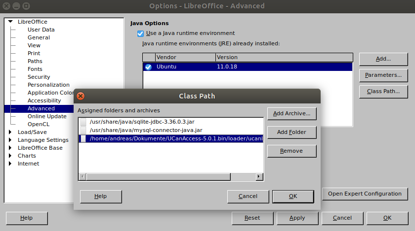

- Call menu:Tools>Options>Advanced
- Click [Class Path…] and point to loader/ucanload.jar in the extracted folder. Confirm the configuration dialogs.

I get an error on test here. My path is /home/ets/UCanAccess-5.0.1.bin/loader/ucanload.jar My class path is

The configuration dialog specifying the class path for ucanload.jar

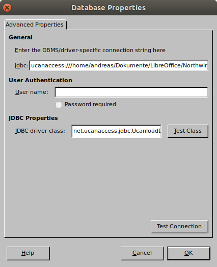

The connection dialog with ucanaccess:///path_to_database_file and with the driver class to be used.

You must not connect the database document to the jar file. The jar file is the software which is able to read and write Access databases.
You register that jar file under Tools>Options>Advanced>Class Path…
Then you connect your database document to the mdb file.

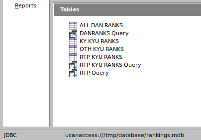

This is your Access database in Base:
- I extracted your files to /tmp/database
- Opened your database file
- Called Edit>Database>Properties… and replaced the wrong path to ucanload.jar with
ucanaccess:///tmp/database/rankings.odb
database is the database folder with your
- rankings.mdb
- the dBase_IV directory where I removed all spaces from file names and applied lower-case file name extensions.
- rankings.dbf.odb is the Base document connected to the dBase_IV directory.
- rankings.mdb.odb is the Base document connected to rankings.mdb. I would prefer this one. It requires that you add ucanload.jar to the class path setting in the LibreOffice options dialog.
