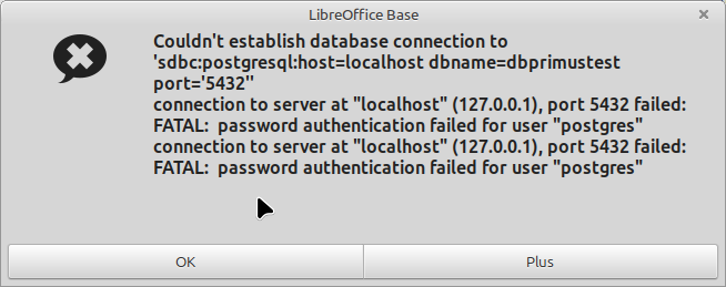

What does the “Plus” button say?
Server side:
service postgresql status
Client side: What is the exact connection string displayed on the status bar of your Base window?
Plus button:
Statut SQL: connection to server at "localhost" (127.0.0.1), port 5432 failed: FATAL: password authentication failed for user "postgres"
Code d'erreur: 1
Couldn't establish database connection to 'sdbc:postgresql: host='localhost' port='5432' dbname='dbprimustest''

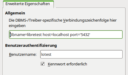

Here is what I see when connection to PostgreSQL is established:
Only the post is shown quotation marks.
So this will be shown in database Properties:
