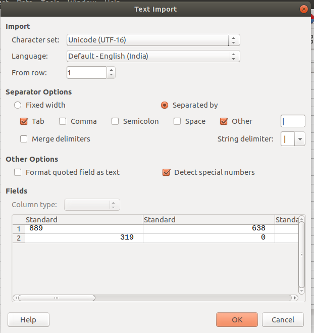

Okay I started using the latest version but still the problem did not solve even after Unticking the Skip empty cells

Hello,
your answer ( which isn’t an answer but additional details and should go to the question details using edit functionality) seems to show you selected | as a string delimiter, which is wrong. | is the separator and the String delimiter should be empty (there is none).
Have tested on my system and if using the same incorrect | setting for string delimiter, this produces the same behavior you face (to be precise: 360239 | 929862 | 375 end up in cell E2, if import starts at A1)
Hope that helps.
