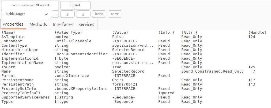

I’m able to open the form SelectedRecord, but unable to get it’s .filter()
:grey_question:
Sub OpenFilteredForm(filtro As String)
	GlobalScope.BasicLibraries.LoadLibrary("MRILib")
	Dim F As Object
	On Error GoTo Erro
	F = ThisDatabaseDocument.FormDocuments.SelectedRecord
	F.open()
	MRI F
	'F.filter = filtro
	'F.reload
	Exit Sub
	Erro: MsgBox "ERRO " & Err & Chr(10) & "na linha " & Erl
End Subtype or paste code here
I understand need do get SelectedRecord > fDetalhes, but how?
Neither F.fDetalhes nor .getComponent(“fDetalhes”) works.
DetalhesOpened
SelectedRecordTree
