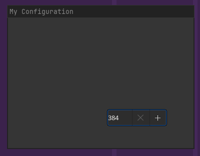

But when I do this, I loose NumericField Spinner controls. Is it needed to force a repaint ?
I initally have a sample that shows the increment/decrement for a Numeric Field like
screenshot-2025-09-11-075254

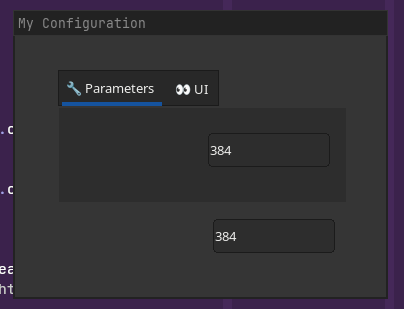

But when I add the code for tabs, the NumericFields look now like
screenshot-2025-09-11-075217

I found a solution to the problem, It was:
  1. Create the components, all from the parent dialog
  2. Make visible the dialog
  3. Insert the components by name that had problems when shown directly.
The revision 3 has working code.
An screencast is here https://youtu.be/x-pbwpxxqzc
Please let me know if there is a better approach to change the code, because it feels like a hack. Can it work without such workaround ? What would a better option? Raw python preferred.
