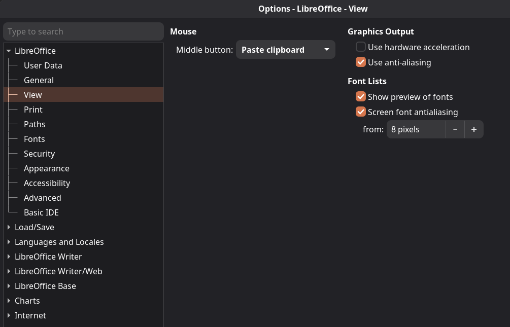

@novaflux of you are on Windows then it might be display artefacts. I get something similar if I don’t do this: click Tools - Options - LibreOffice - View and tick the box Force Skia software rendering.
Hi @EarnestAI
Thank you, for the suggestion. But, I could not find the option - Force Skia software rendering. Am I missing something ?
In that case, you are not using Windows but some other operating system.
Make sure your display drivers are up to date.
See if ticking the hardware acceleration box and restarting LibreOffice helps
Sorry, I should have specified this earlier.
I m on Manjaro Linux OS, not Windows.
This is not enough because there are several possible “desktops”: GNOME, MATE, KDE Plasma, Xfce, LXQt, and many others. Which is yours? And have you configured LO accordingly (with an ad-hoc graphical interface package)? Tell us which desktop you chose and report Help → About LO (there is a button to copy the information) so that we see if ths is consistent.
