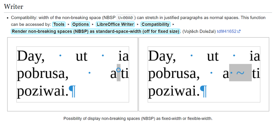

Release Notes 24.2:
There are other space characters with no-break property in Unicode. You could try U+202F NARROW NO-BREAK SPACE.
You can easily insert it with Insert>Formatting Mark>Narrow No-break Space or Alt+Shift+Space. If under MacOS, check keyboard shortcut.
