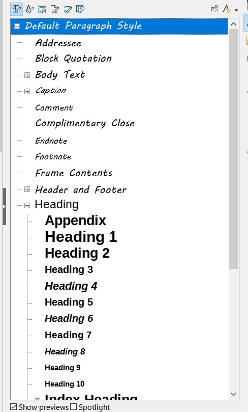

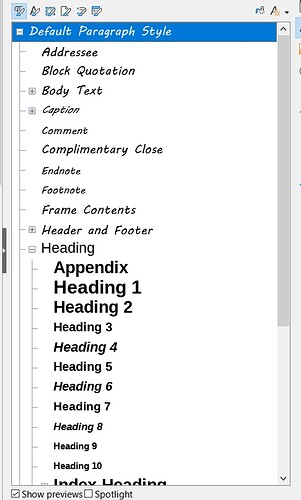

I changed the default paragraph style font to something distinctive and all the inherited styles refreshed in the Style sidebar. As you can see, the Headings didn’t change, even though they inherit from default paragraph style (and I tested this by typing DPS text and then some text with a heading style.

As you can see in the hierarchical view, styles are organised in a tree-like structure. Default Paragraph Style (DFS) is the ultimate root from which all others inherit. But there are also “sub-roots”, such as Body Text or Headings (more generally all those with an expand/collapse control). When you change an attribute in these sub-roots, you create an override and break the inheritance chain.
This is the case for Heading where font face is factory-configured for Liberation Sans while DFS is Liberation Serif.
