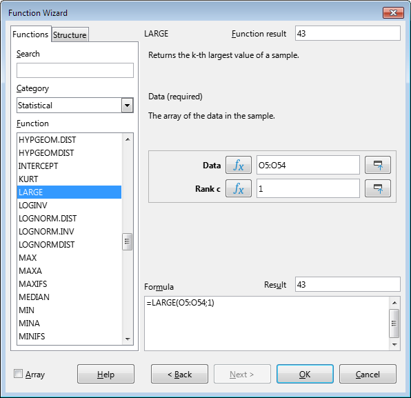

From the sample spreadsheet you provided, and from the code contained in that file, it is difficult to understand exactly what the project is supposed to do. It seems that we are talking about a list of participants who accumulate some game points during the week and change their position in the leaderboard at the end of the week. But for some reason, the results, game points are filled in manually. Why not automatically? You asked the question “how to paste the contents of the clipboard into the Find&eplace form”, and in the explanation you said that you are trying to find the top five in this way. Have you ever thought that you can find the best values, for example, using the LARGE() function? Or you did not know about the existence of functions in the Statistics section?

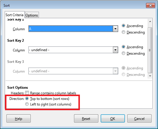

Have you seen this part of the Sort window?
Hi,
I had never gone to “options” tab ,where this feature is on my version, before, so thanks for that.
Recognizing your dislike of macros, do I really have to create a macro individually sorting each of 50 lines or is there a better way? Unless I can go into the macro code, identify the set of lines doing the sort and copy/paste them 49 times!
As far as I could determine it will not sort, in one hit, multiple lines in a block into individual line ascending order.

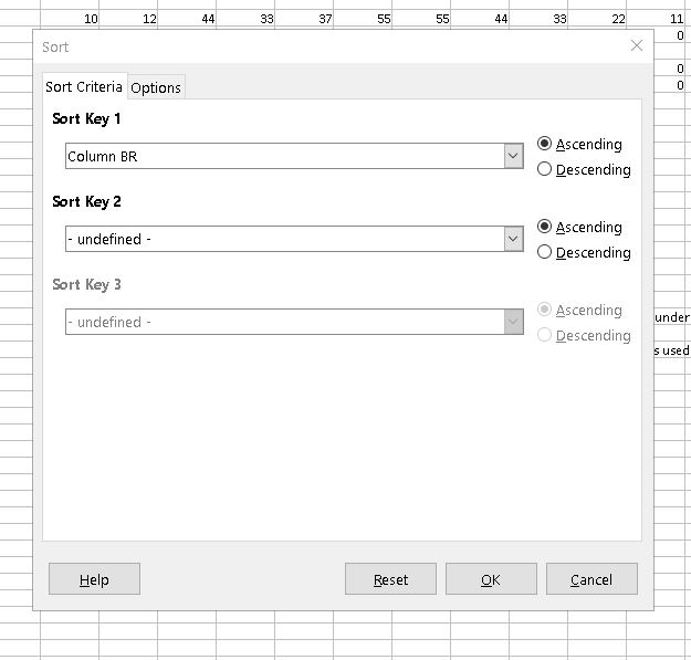

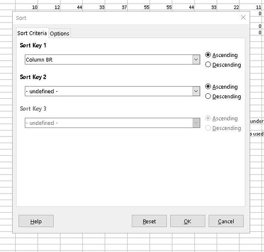

I attach a pic of my sort page to clarify my comment. Version in use is 7.3.2.2(x64).
