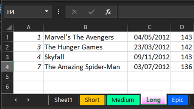

Screen Shots Of _Excel Macro Result
![image|690x330](upload://bHDzu0vSjclmGH69GwsCORGhVQP.png

        cursor = sheets[name].createCursorByRange(sheets[name]["A1"])
        cursor.collapseToSize(len(data[0]), len(data))
        cursor.DataArray = data
