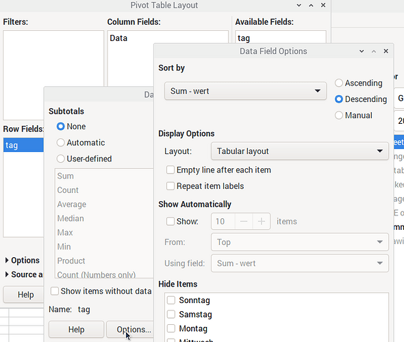

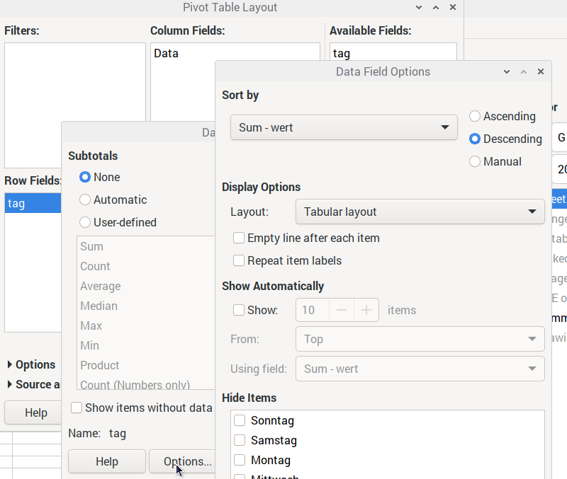

Try the attached File:
pivot_sort_by_value.ods (25.5 KB)
Setting to sort by Value doubleclick tagOptions:
