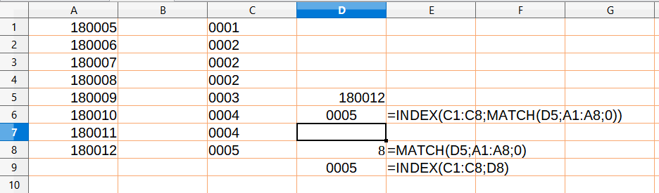

I can’t see the issue, please test if with attached file it works.
Test file
Looks the cell is formatted as text, so anything introduced in it, it’s done as a literal text. Use [Ctrl+1] and Number tab to see what is the selected format.
Your test file works like a charm. I’ve believed that the formula was correct, that there was something else happening to impose the ceiling on the INDEX/MATCH as well as the LOOKUP and VLOOKUP formulas.

If your cells show the formula, together with the symptoms you described in your original question, it is very likely that your cells are formatted to Text, which forces any input to stay a text string instead of evaluating it as formula, and numbers entered will also stay text, which makes functions like VLOOKUP() and MATCH() fail that expect a range to be sorted but numbers sort before text so if you mix numbers and text they are in fact not sorted and the result is arbitrary.
