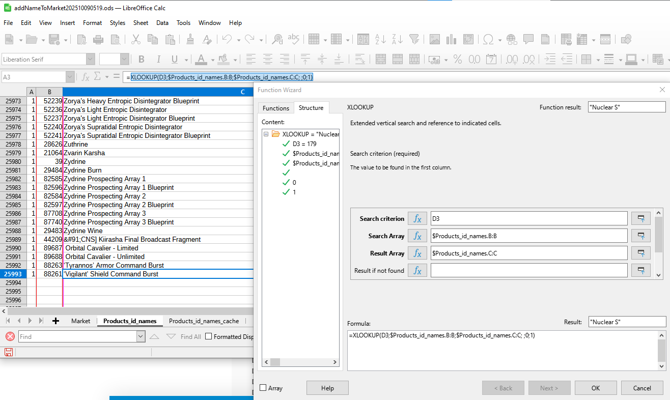

I have sheets “Market” & “Products_id_names” ( CellRange “A2:B1048576” :face_with_hand_over_mouth: )
I add “market” list/rows ( with only products id numbers (col. C) and other data (col. D, E, …) ).

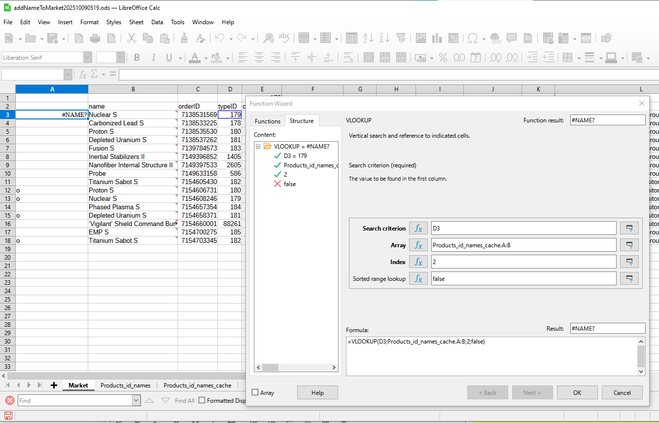

I’m traying uselessly / to no avail :
=VLOOKUP(C2;Products_id_names!A:B;2;FALSE)
Even when pointing to locations in the VLOOKUP function window with the mouse cursor, it does not return a result ("#NAME?")

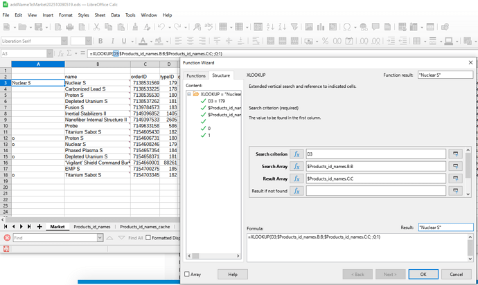

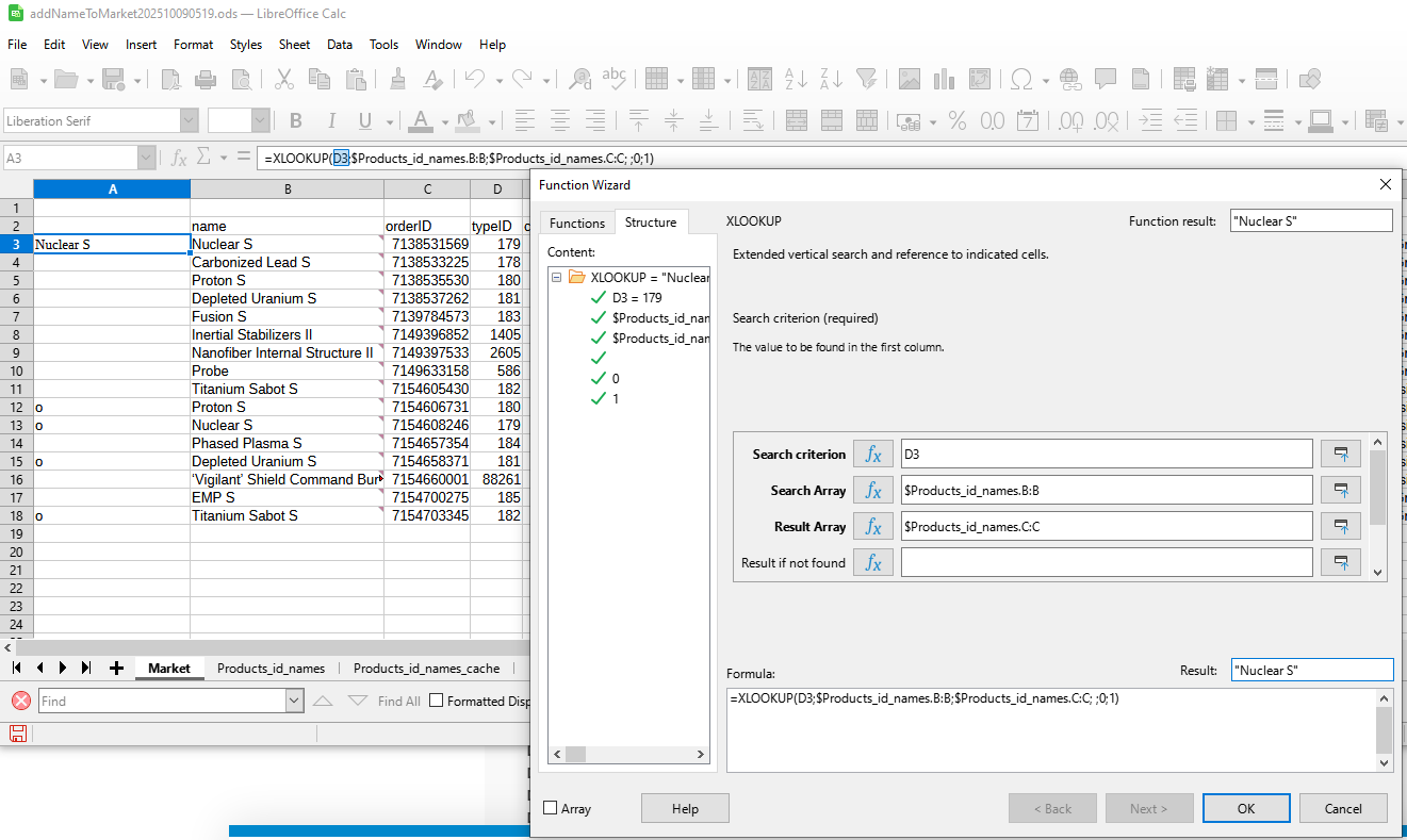

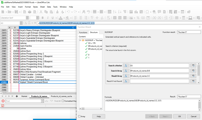

I finally found a way/solution to display names corresponding to id numbers (solution) like this:
=XLOOKUP(C2;$Products_id_names.A:A;$Products_id_names.B:B; ;0;1)
Since the function only displays the id names and you can’t just copy-paste the names elsewhere, I still had to use a macro (BASIC).
There were several attempts to do this (initially, to change the id number to a name and add a comment (note , Annotation ) to the id number cell).
The macro did the name change, but there were problems with adding the comment (it only added/changed the ID number to the cell where there was already a comment before, but it did not add a comment to the cell without a comment).

Why was it so difficult to find a solution to add a comment and where is the detailed manual for adding a comment to a macro BASIC cell?
Some older Office (Free Open Excel xD) used a different way of adding a comment to a cell? How can I debug such a problem better, to find out why it doesn’t add a comment (my debugging was as if there was already a comment) (now I think maybe the order of the commands was wrong, first you have to add new content to the cell or after that and then the comment or before)
This is what I needed for Eve Online :rocket: :ringer_planet: :rocket: :milky_way: :artificial_satellite: :comet: :space_invader: game marketing ( Presonal Market Export information ( C:\Users\kati\Documents\EVE\logs\Marketlogs\My Orders-2025.10.08 2134.txt ) order typeID column to to change/add the product name ( I copied the database adam4eve.eu/info_types.php ) and to be OffLine (Eve-Offline :face_with_hand_over_mouth: ) (without using an online database or excel SDE) )

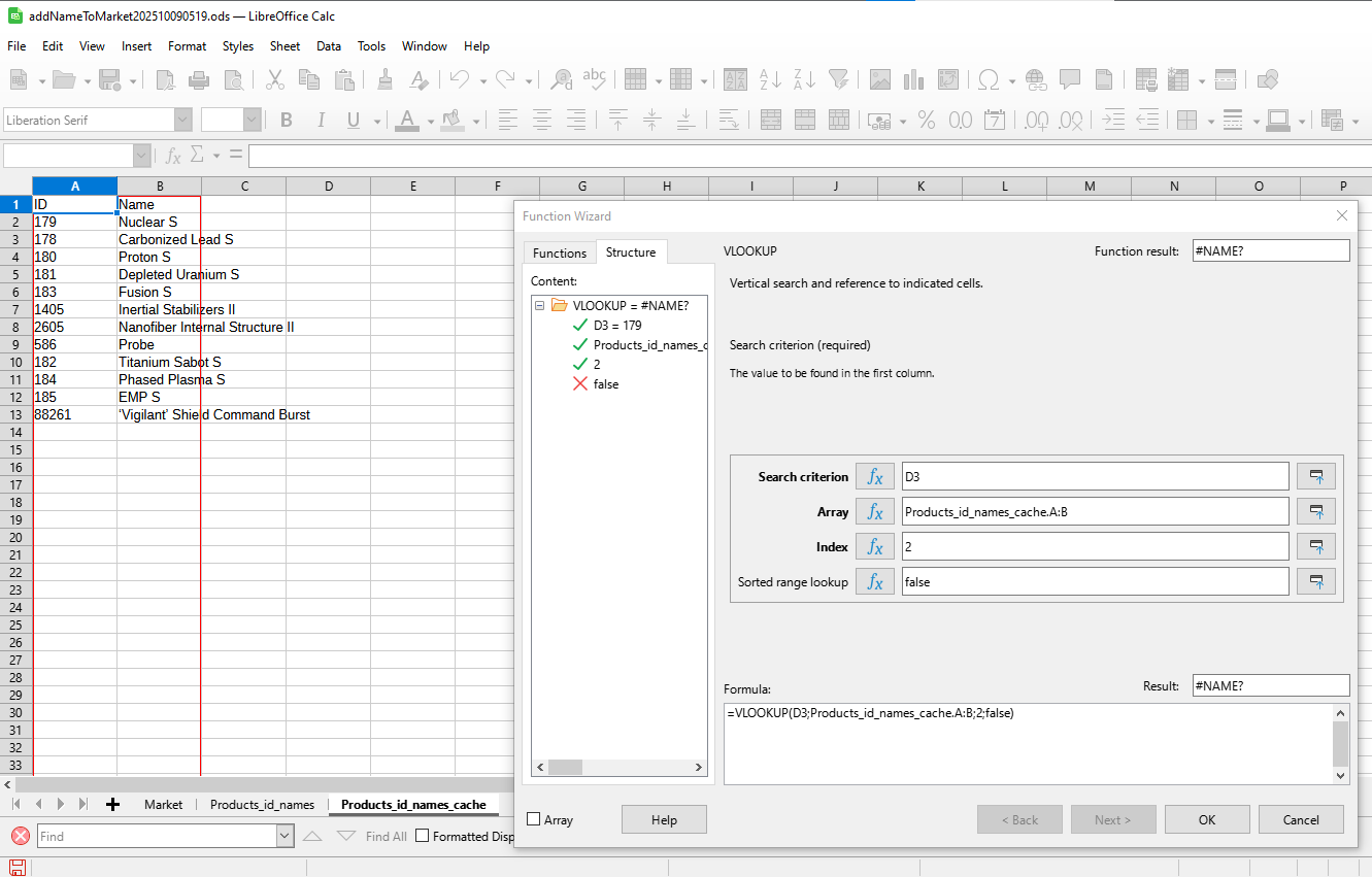

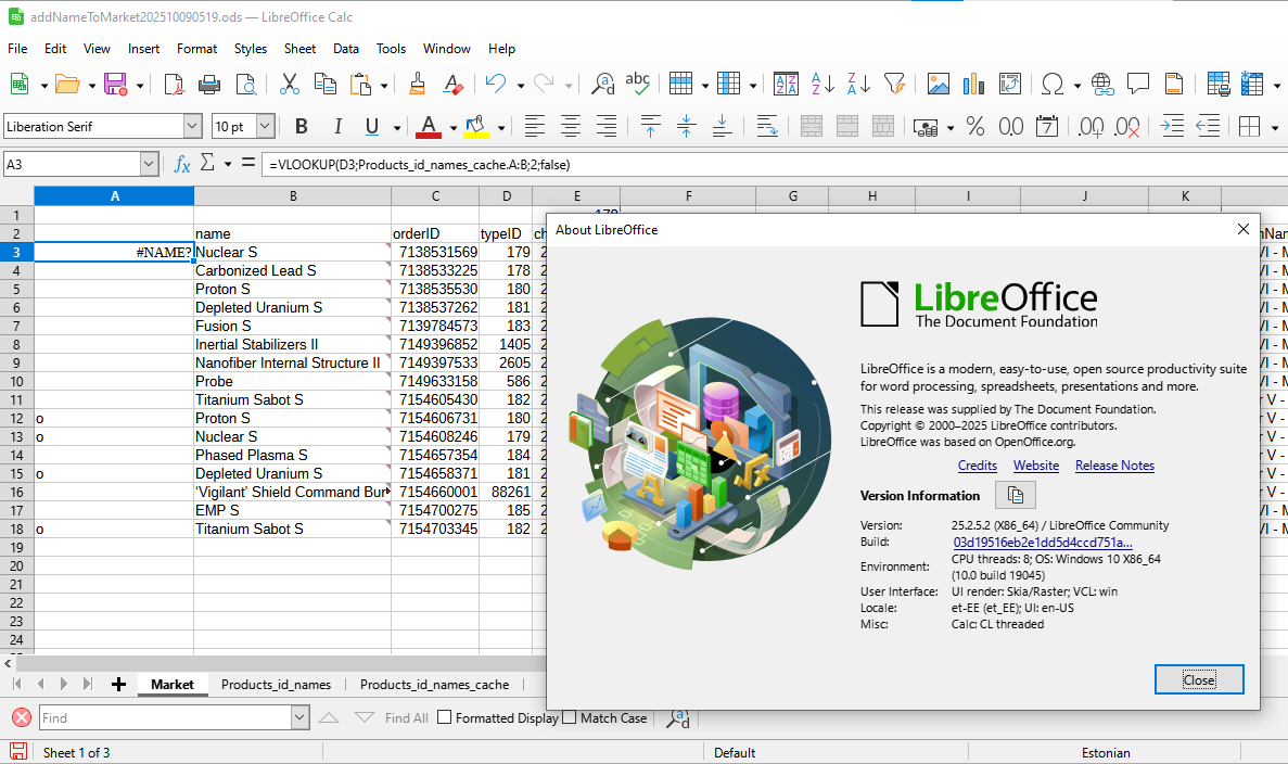

try Calc addressing
=VLOOKUP(C2;Products_id_names.A:B;2;FALSE)
BiG PROBLEM’S ( Noobs dont know this so easy ):
Error: If the cursor is inside (not the main function but an additional function) e.g. Function Min() and you run a macro, you get the error:
BASIC runtime error.
Argument is not optional.
Cause: In LibreOffice Basic, macro execution attempts to execute the function on which the cursor is located. Function Min(a As Long, b As Long) expects two parameters (a and b), but when you run it directly, no parameters are provided, which is why the error occurs. If the cursor is inside Sub AddNameToMarketColumnBAndAddNoteWithVLOOKUP(), the main macro runs correctly, as it does not require arguments.
Solution: Make sure that the cursor is inside Sub (or select the exact name of the macro from Tools > Macros > Run Macro). This explains the previous anomalies, as running the wrong function can cause unexpected errors.
( code work w oFunction.callFunction(“VLOOKUP”, Array( max 2 sec and w/o VLOOKUP +10sec ( Products_id_names table have A1:C25993 rows data (id+names) . In addition to increasing speed, it creates a cache table so that you don’t have to use a larger table every time for product names that have already been found. Which already gave a noticeable result (work time) even without VLOOKUP. ) )

			foundName = oFunction.callFunction("VLOOKUP", Array(lookupID, oSheetCache.getCellRangeByName("A2:B" & cacheLastRow), 2, False))
			If Err.Number = 0 And Not IsEmpty(foundName) Then REM Debug: Leitud nimi cache-st ID-le & lookupID & : & foundName

I guess I had already tried that (without success),
maybe there is a problem with the sheet name or some other stupid excuse (or some version bug)
So the only solution was =XLOOKUP()
( =XLOOKUP(D3;$Products_id_names.B:B;$Products_id_names.C:C; ;0;1) )
