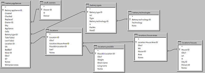

But if I first click ‘Switch Design View On/Off’ to see/and possibly edit the SQL with the GUI editor:
And then if I click ‘Switch Design View On/Off’ again to return to the SQL text view, I now have this FROM statement which is broken by inclusion of two extra }, {s:

Screenshot from 2023-12-17 07-02-56
