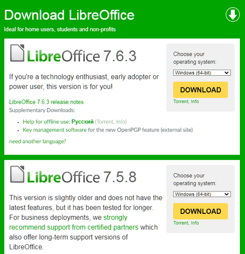

Each new version of an office suite usually contains bug fixes. Perhaps installing the current version instead of the existing 6.4 will immediately solve the problem?

I’ve had this problem for quite some time,
no matter what version of Libre Office I used,
so I very much doubt that updating it will solve the problem,
but who knows…
