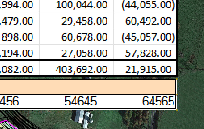

White space added to right & bottom axis when pasting libre calc table into other programs
I’ve have tried pasting a table in both AutoCAD and Bluebeam, and I get the same thing in each. Libre calc add space to the table on the right and bottom edge almost as if it was drop shadow or embossed effect. See picture of two charts pasted into Bluebeam, top chart is one pasted from excel and bottom was pasted from libreoffice. Is there any way to remove this? I tried searching the forum but haven’t found anything on this.

The object handles are inside the dotted blue line. I wonder if the blue box is an indication of padding applied by the receiving program? Does it disappear when deselected? The question should really be asked at AutoCAD or Bluebeam
I believe that AutoCAD added extra code especially to allow Excel integration. I would stick to Excel in that case, the cost is small compared to AutoCAD.
Yeah it appears still when deselected both in AutoCAD and Bluebeam. I will ask those forums as well and see if it’s something on their end.
