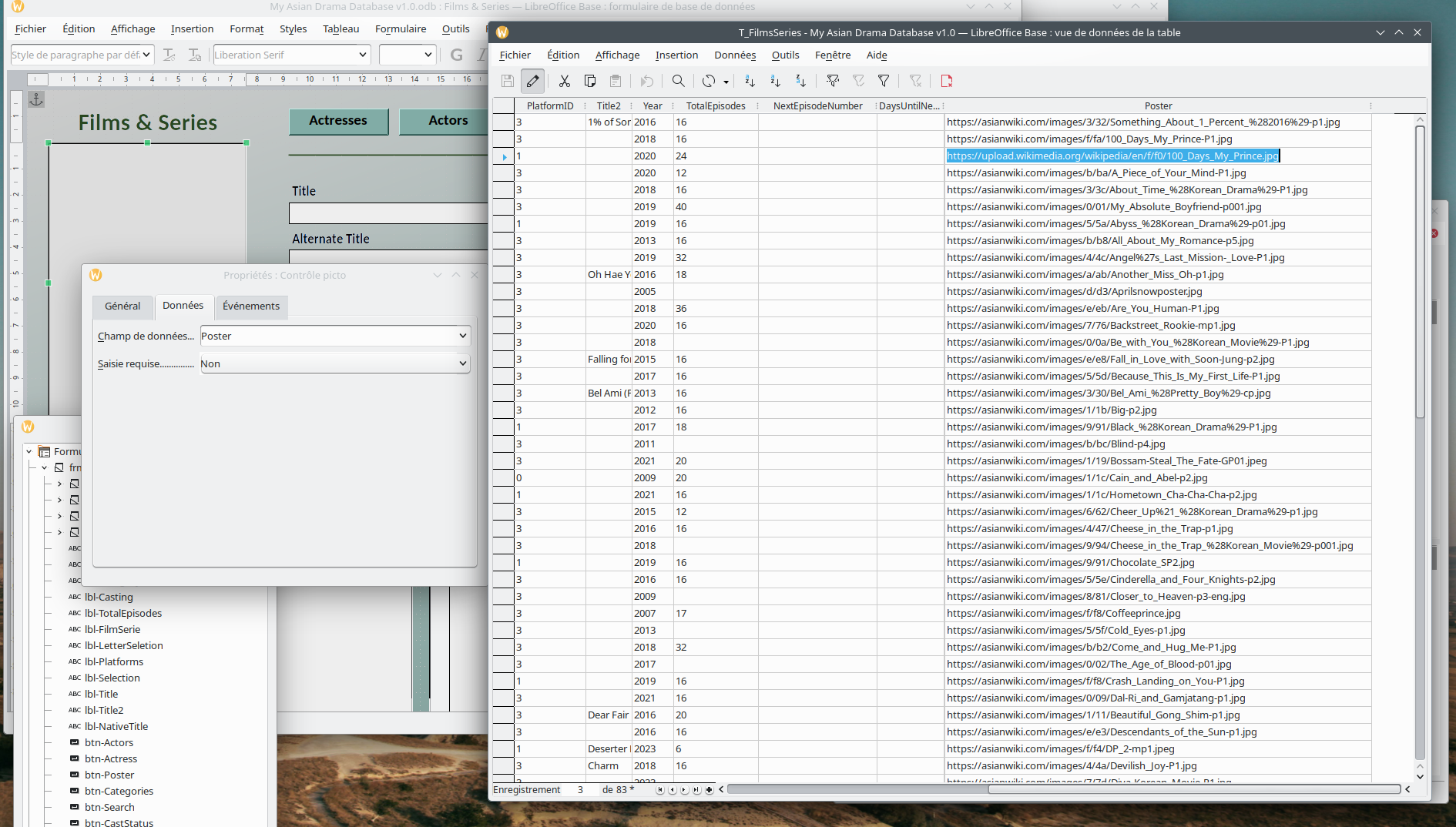

If you look at the screenshot, you can see the assignment of the ‘Poster’ table field from the T_FilmsSeries table. The ‘Poster’ column of the table contains all the URLs associated with each record in the form.
The macro was used to automate the insertion of URLs into this table field, and it works very well. This avoids manual copy/pasting.
As I’ve mentioned several times, on Windows, the image control dynamically displays the image corresponding to the URL in the Poster field, but this doesn’t happen in LibreOffice on Linux.
