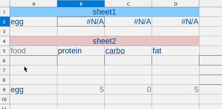

Why vlookup return error when i moved reference data?
i want to keep a record my ate meal everyday.
i make egg(one) data in sheet2.
i want to use row 6 data as variable in programing.
i try to get row6 data by vlookup function in a2 cell.
but when i moved row6 data,b2 and c2 get error.
how to get row6 data without getting a error?
please help,

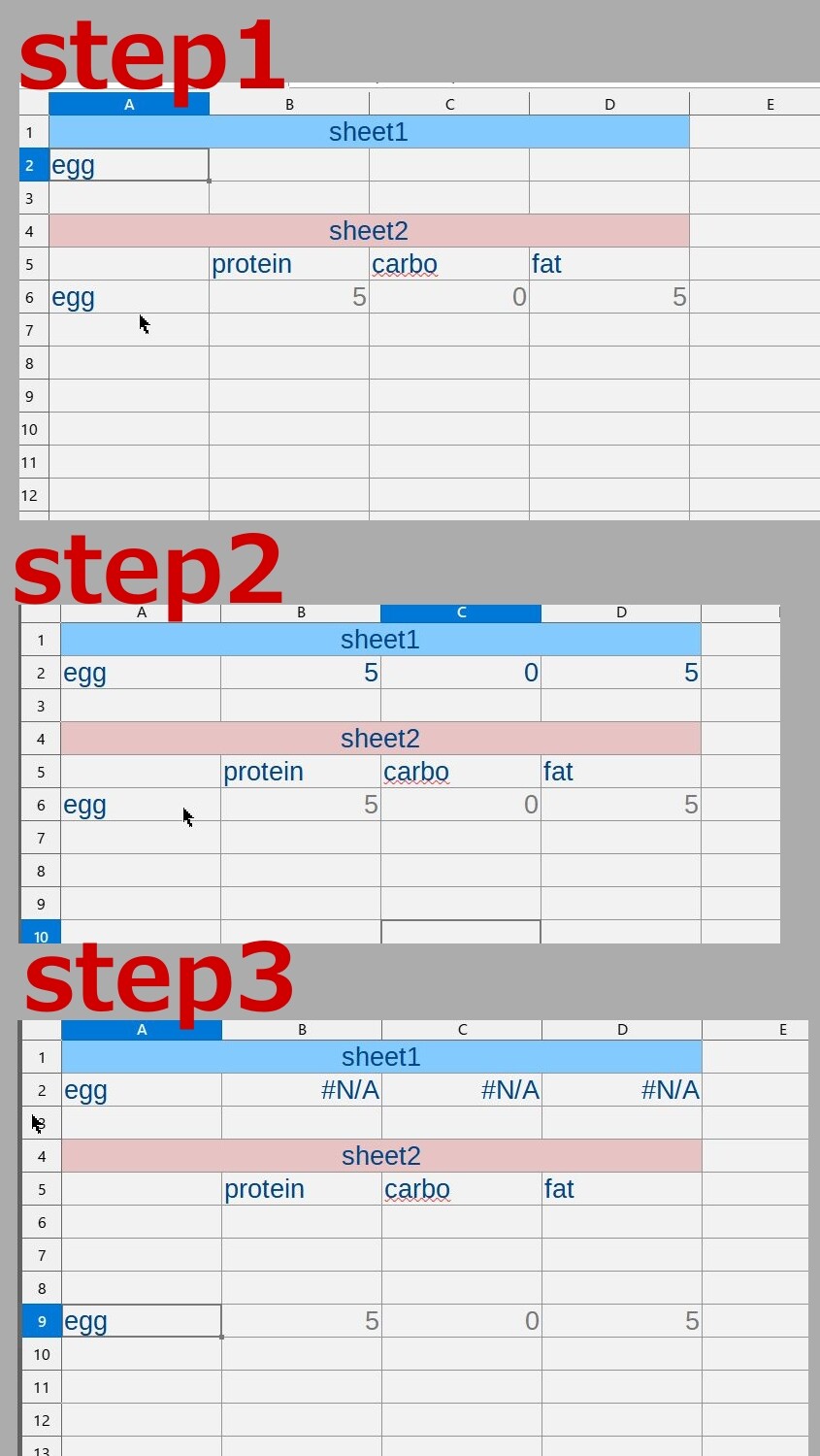

step1 i write this formula to a2 cell.
=VLOOKUP(A6,A6:D6,1)
sorry i changed this formula.
step2 i use fill copy to D2 from A2.
step3 i moved reference data.but i get error in row 2.

@erAck ,thanks for comment.b2,c2,d2 formula is like this after the moved to row 9.
=VLOOKUP(B9,B6:E6,1)
=VLOOKUP(C9,C6:F6,1)
=VLOOKUP(D9,C6:F6,1)

it this bug?really?
You still did not answer how you move the data row. If in row 2 I have
A B C D
=VLOOKUP(A6;A6:D6;1) =VLOOKUP(A6;A6:D6;2) =VLOOKUP(A6;A6:D6;3) =VLOOKUP(A6;A6:D6;4)
and then select A6:D6, Cut (Ctrl+X), and Paste (Ctrl+V) on A9 then the formulas are correctly adjusted to =VLOOKUP(A9;A9:D9;1) and =VLOOKUP(A9;A9:D9;2) … and the results are still the same. The same if I drag&drop the selection of A6:D6 to row 9.
The examples you give suggest that you did something completely different.

i set this formula in A2 cell.next time i use fill copy to D2 from A2.
your sample work well,when i moved 6row to 9row.i not get error.
