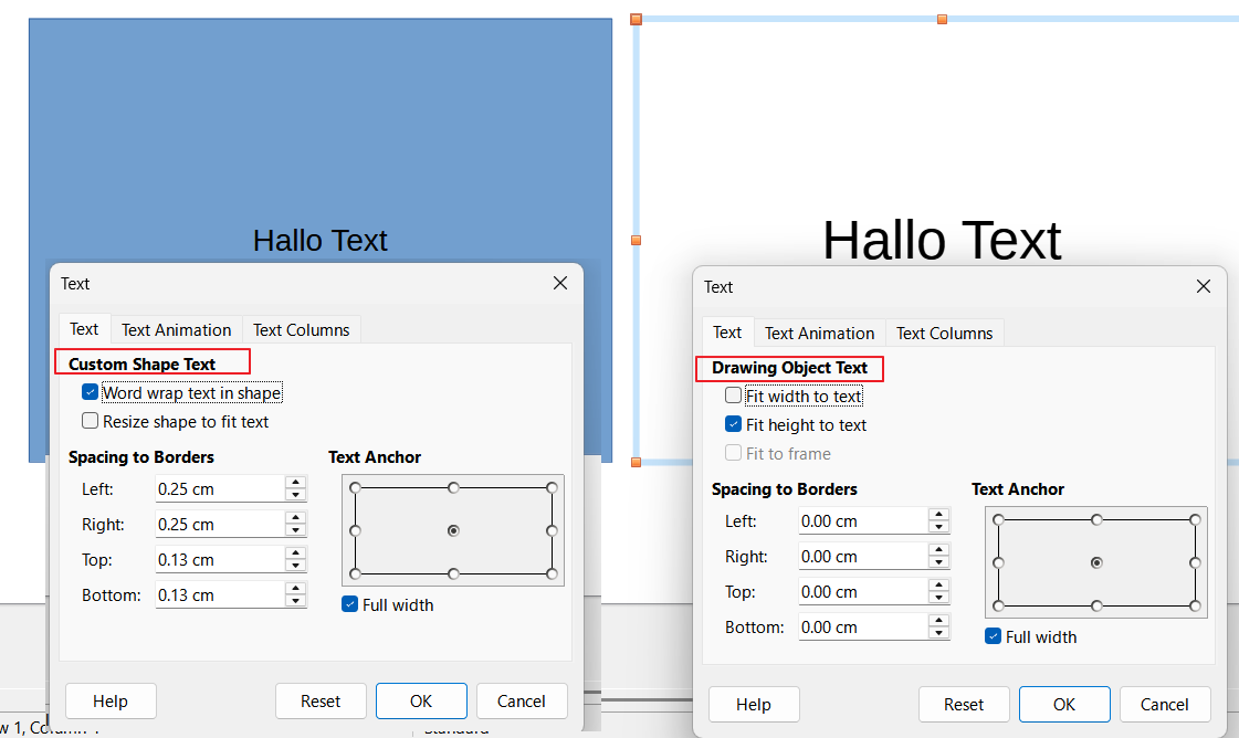

Text wrap behaves different depending on the kind of shape. The setting is in “Text attributes”. In Impress, that is in menu Format > Text box and Shape:
  • rounded rectangle from toolbar “legacy rectangles”: It has “Adjust to contour” and “Fit to frame”. You likely do not want any of these.
  • text shape: It has wrap as default after you drag the horizontal handle to change its width. The position of the text block is specified in the “Text anchor” part. In case of a rounded text box you need to adjust the distances manually to keep the text inside shape area.
  • rounded rectangle from category “Basic shapes”. That is a custom shape and as thus has a predefined text area wherein the text is positioned. This area adapts to the rounding so that you do not need to adjust the distances manually.
    A remark: The anchor position does not determine the text alignment, but determines in which direction the text expands when it becomes larger. The alignment is always given by the paragraph style.

Double-click on the text, open context menu, Text…, Text tab, activate Word wrap text in shape.
First you must select the text (not the shape).

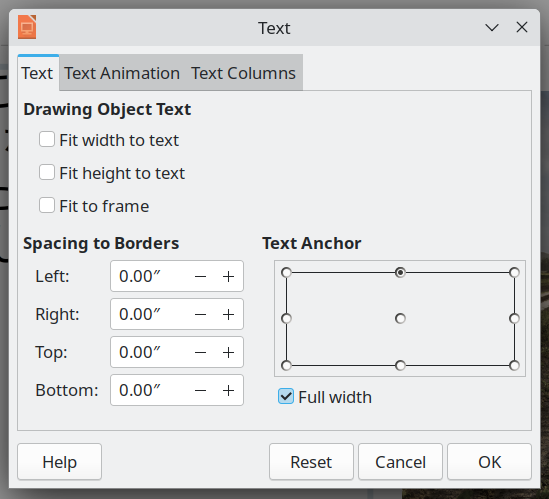

these options do not show up in libreoffice impress 7.4.7.2
here is what I can see when trying to wrap text (none of these options work)
@junovicz
I see, so The default text boxes do not support wrap text, I should then manually replace them with custom shapes them.
Thanks
Each text box supports wrap text. Only make sure that “Fit width to text” is unchecked.
