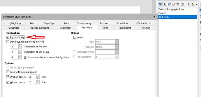

The global hyphenation is set in the Tools/ Options/ Language Settings/ Writting Aids.
Also it is possible to set the hyphenation for the Style.
And the same only for the current paragraph (Format/ Paragraph).

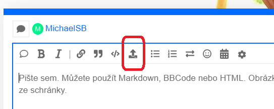

I don’t know hebrew script (so I’m not able to create a correct file for testing), but you mentioned you don’t know how to attach a screen shot. It is easy, there is the icon for it when you write a comment (or edit the ask).
You can create one ODT with example hebrew text and put the screen shots to the ODT with good and bad possibility and upload here the ODT for testing.
