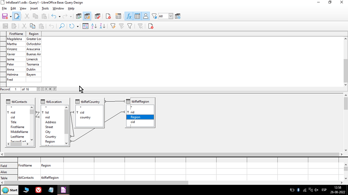

Work around for COALESCE in query
WIN 10, LO 7.2.3 , HSQL 2.61
Generic query design question involving listbox bound value in underlying table
Table x has a field “Region” - Integer
Value comes from listbox in form A
A multitable query provides the data for form B
If the Region field of a record in Table x has no value, the record will not show.
COALESCE will not work.
Is there some other way to display the record with a missing Region ?
Thanks

@maya1 : Seems you connect two tables like
SELECT "tableA".*, "tableB".* FROM "tableA", "tableB" WHERE "tableA"."RegioID" = "tableB"."ID"
This will show only values from “tableA” and “tableB” where “tableA”.“RegioID” isn’t NULL.
SELECT "tableA".*, "tableB".* FROM "tableA" LEFT JOIN "tableB" ON "tableA"."RegioID" = "tableB"."ID"
Will show all rows of “tableA”.

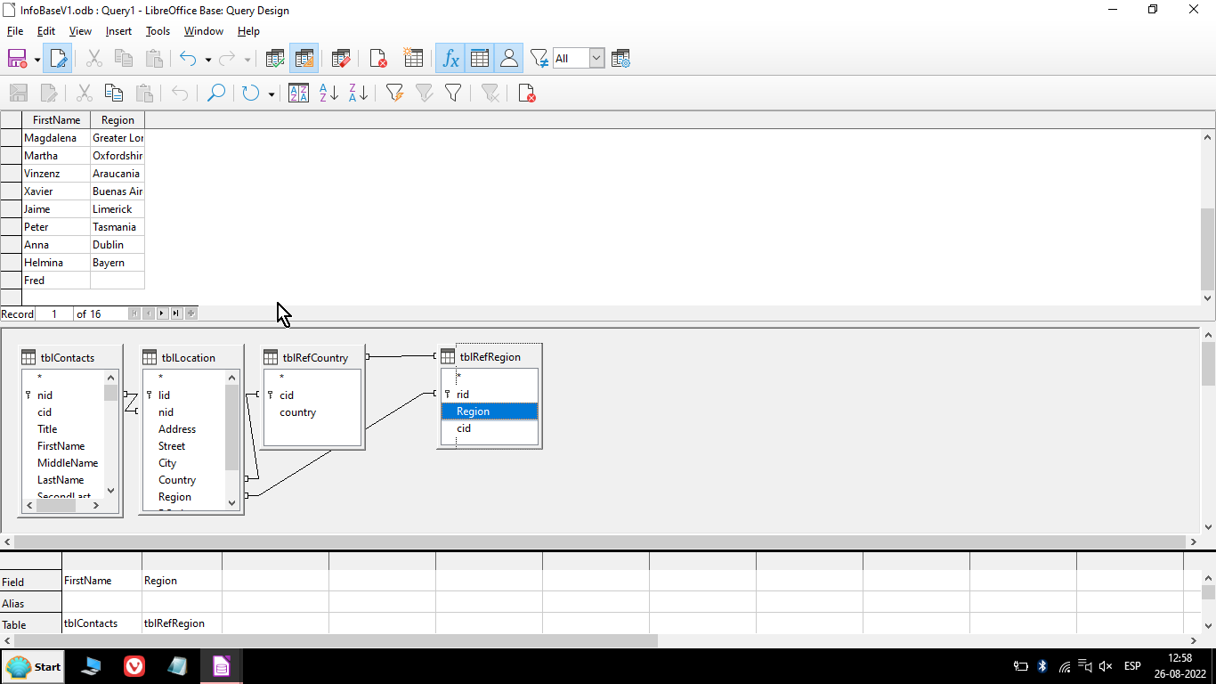

Thank you all for your help, turns out the problem was a table relationship set some 2 years ago.
Removing the link between country and region solved the issue.
