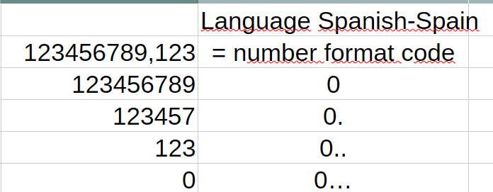

You can divide the value represented by a thousand with each thousand separator you add at the end of the number format. ‘.’ or ‘,’ depends on the cell language.
Perhaps this is what you need.
