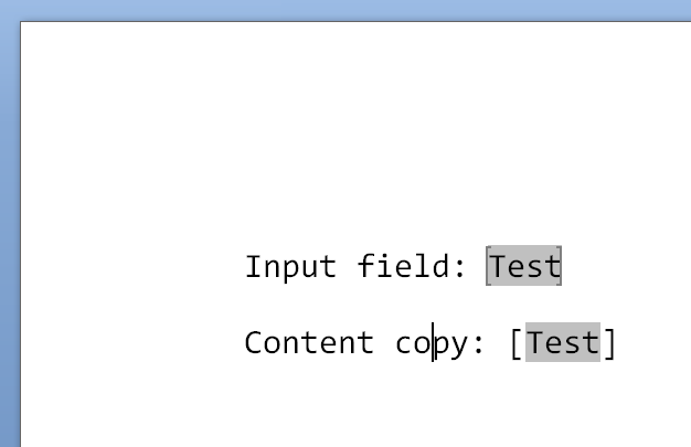

In MS Word it looks like this:

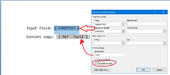

Basically here the first line has a legacy edit box with a bookmark name assigned to it (let’s call it “Text1”. Importantly, the legacy edit box has “Calculate on exit” option checked. And the second line contains { REF Text1 } field.
Then you protect the document allowing only form filling and every time you type something in the control (edit box) and tab out of it, the second line text gets updated with whatever you have typed.
