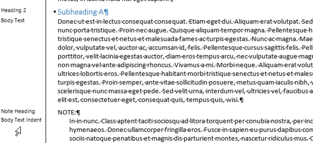

While I am loathe to accept it, I fear that :“formatting residue” is highly likely. Many of my documents that were originally in MS Word went back and forth between Word and Open Office, sometimes several times, before I imported all into .ODT in Writer. I’ve been a victim of various entities enslaved to MS Office products for many years, sometimes working in Word, sometimes importing into a more functional program and format.
@Zizi64 Thanks for the styles suggestion. I definitely intend to move in that direction. I haven’t made such a move before now due to the import and export I have had to do and different programs I have to run. Thus nearly all formatting I use has been manual.
But now I have the option to discriminate. If it isn’t in .ODT or I can’t deliver the transcript or proofing or whatever in .ODT I won’t take the job…
Even Word has styles and Excel has cell styles similar to Calc. Nobody uses them due to pure ignorance and because the user interface does not suggest any such feature.
Thanks very much for the info and link. I would dryly note in that linked info the word “style” isn’t used at all until a person digs six levels deep and then only the obscure mention of “style pane width”.

@Villeroy I expected this. An older version of Word, checking the styles their way. Two of three documents checked are left panel identified only as Paragraph. No indent mentioned. Most likely the style tool only catches Styles made by Word in that version. Export then import back and Styles aren’t reliable.
