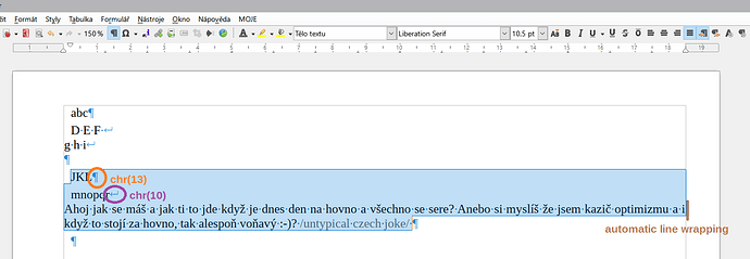

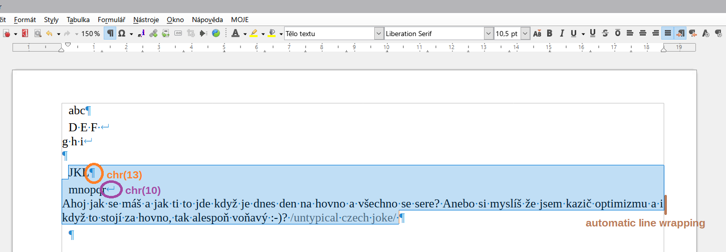

What do you mean by line wrapping and actual returns? chr(10) or chr(13) or automatic wrapping at the end of line?
