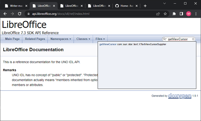

Additional question: where is the API reference? I’ve struggled to find the documentation. For example, I’ve checked the wiki.openoffice.org site, but besides being OpenOffice rather than LibreOffice, it seems to be a collection of examples rather than an API reference.
api.libreoffice.org
If I wanted to view, say, all the public methods of the ViewCursor class, where do I find this information?
Use extension XRay or MRI
In Development Tools (or in MRI).
The object returned from getViewCursor implements XTextViewCursor interface. That you can learn from the API documentation itself (going to the link above, opening IDL reference, and typing getViewCursor in the respective Search)
But that would not give you the full list of the methods/properties of that object - just the guaranteed minimum, i.e. what the API contract offers. The real object will implement also other interfaces, and their set may depend on the cursor position; and unless you want to read the source code, the best is to use introspection tools mentioned above.
