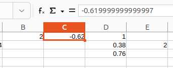

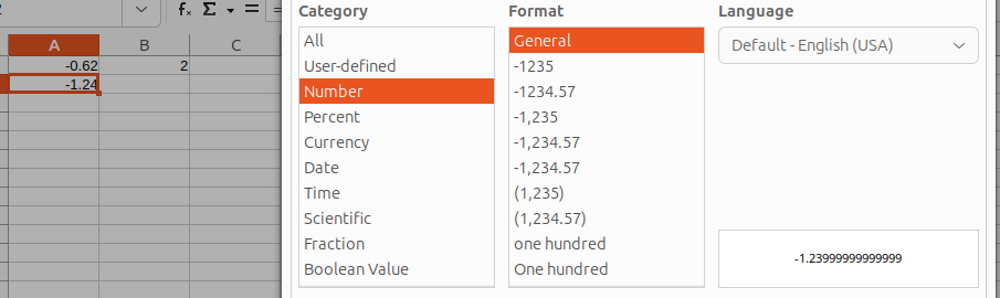

Are you sure? Which is the cell format? What happens if you set it to 0.0000000000E+00? Reminder: this does not change the value, just how it is displayed.

In your case, the difference between 0.62 and 0.619…77 is 3 10^-15, i.e. in relative value 5 10^-13. Such a tiny difference is negligible in most practical situation.
I agree with you that a human prefers to read 0.62. This is the role of cell format where you specify how many digits you want to see and Calc will do the visual rounding.
This is for general-purpose calculation. You are in an accounting context. This context also introduces rounding conventions (not truncation). This rounding is necessary every time you multiply or divide to reconcile what you (want to) see and the value kept in the record.
To do that, I systematically write =ROUND(…; 2) around accounting formulas involving multiplication and division. By doing so, I make sure that the value shown is exactly the same as would be used in later calculations. To avoid “cent errors” (as can happen if you SUM() “raw” values and in parallel rounded values, you must follow a strict discipline where you chain only rounded intermediate values, not recomputing them every time you need them (this means your formulas in the end are extremely simple because you store in separate cells scratch intermediate values when they have an accounting sense).
