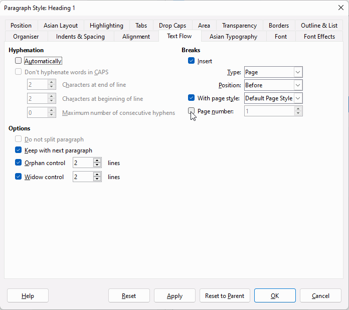

  • Heading 1 is usually used for Chapter Numbering. As it is a chapter you will normally want to set a page break beforehand. You can set the page style, Default Page style is OK. As you are including the chapter number in the numbering you will probably want to reset the page numbering back to one for each chapter. Tick the box the cursor is over for that

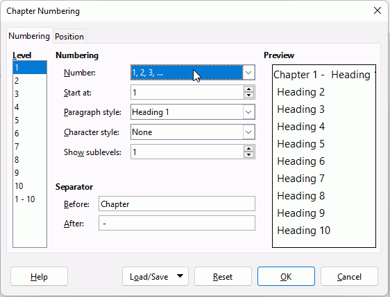

  • Chapter numbering is under Tools > Chapter Numbering. Here are some settings but consider whether you want the number preceded by "Chapter - " as shown in image (to copy your apparent intention). "Chapter - x " will appear in footer too, see sample
    ChapterNumbering
