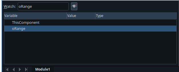

I see, but the listed variables didn’t show any properties? I’ve tried a sample script (shows contents of selected cells):

but that’s all it showed (there were no context menus or options available to expand them):
Oh yes, they would show anything only when the code runs. Put a breakpoint (even at the very start of a function), and run it.
ooooh now it makes sense :slight_smile:
Thank you very much, that changes the game completely :clap:
