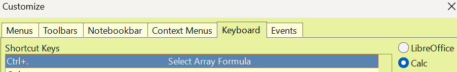

[Ctrl /] to select the array range when in one of their cells.
Thanks for the hint. The command isn’t in “Edit > Select”, and the hotkey is one that doesn’t work on a German keyboard.

If it doesn’t work in a German layout, maybe because it is a shift key, it happens in a lot of languages.
But it is really simple to change in Menu>Tools>Customize>Keyboard.
