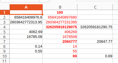

calc: are decimal correct calculations possible?
Screenshot from 2025-08-25 09-29-51

Sorry, copied from wrong row or typo, try 0.54 + 0.57, Calc will display 1.11 and trunc to 1.11, however that’s combining faked display for IEEE result 1.1099999999999999, and “fuzzy rounding” with a 4 bit? “snap to zero”. Here working correct, but try to estimate how long it will hold. Or memorize the already mentioned “There is nothing exact in floating-point calculations in Calc, …”, Mike Kaganski 2023 in “comment #5 in Calc Round Down is Rounding Up for some values”, * [Online]. Available: 154792 – Calc Round Down is Rounding Up for some values, retr: 2025-05-13, mentioned in C#54 here, and evaluate the title of that thread reg. reliability of trunc ( which is rounddown direction 0 ).
My approach here tries to be the practical use of Spreadsheets (here = Calc of course), not a theoretical one.
So users must be aware of floating point arithmetics. For e.g. Accounting, employ TRUNC according to local currency.
For other professional fields, also the user (we Engs. etc…) must employ the tool (Spreadsheet) accordingly.
