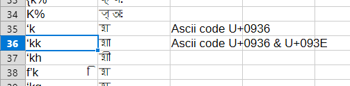

And entries aren’t sorted according to length, for example lines 35 & 36
1
That means the character U+0936 will be replaced always, but U+0936&U+093E never.
