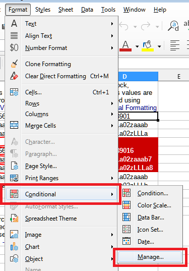

Try Format-Conditional-Manage… and Edit
While this may sound difficult, it is actually very simple. Indeed, create a conditional format for one cell (check it works correctly). Now copy this format with the Clone tool
